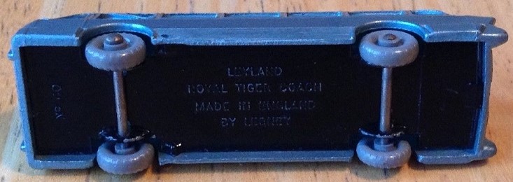

Found a Leyland Tiger GPW with a narrow rear offside wheel (lower one in the picture) :)
Happy collecting :D
Sebastian
