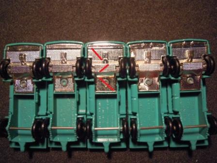

Re: 1e Mercedes Truck
Some on my crosshatch bases as Dick and Bill has mentioned before
a) straight front bumper, thin step
b) straight front bumper, top of step in line with bumper
c) straight front bumper and tow guide, top of step in line with bumper
d) front bumper with extension and a tow guide, top of step in line with bumper
e) front bumper with extension and a tow guide, top of step above bottom of the front bumper
- DSCN6282.JPG (32.34 KiB) Viewed 7214 times

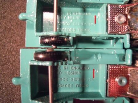

Quite interesting. As I have checked my spare models, I have found two different early models (without brace above the rear mudguard) with different type of the text
