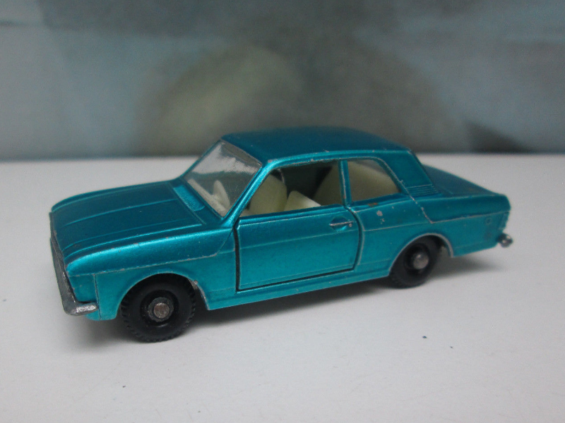

Saw this and I have never seen this before, looks to be a regular wheels with the superfast blue paint on this cortina. I dont see anything on this in variation guide but it did say something to be a pre production, what do you guys think.

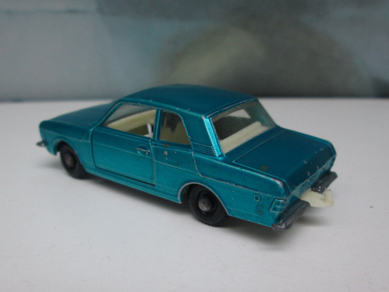

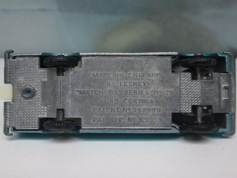

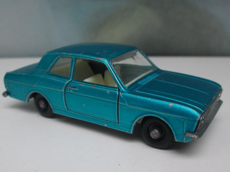

Hello Kiov, Kwakers here. The body paint on your blue Cortina looks factory original to me, the base rivet seems to never have been touched or modified from the OUTSIDE, but the axle ends on your Cortina do not look like Lesney original factory rivets to me. I would suspect a body rivet that has been cut and re-glued to install a Superfast body on this regular wheel base, but why were the axle ends modified, or even touched if it was just a simple SF body to RW base swap?? I will wait to see what other members think on this one, but those are just my observations and suspicions on it without being able to inspect the model closely "In my Hands". Kwakers

This exact one with exact same backgound has been offered on a site in The Netherlands (ans in the meantime obviously sold) by a seller who offers too many VHTF models, so many that it could be Aladdin's cave and Paradise in one!
Seller offers under a various number of aliases on - as to my knowledge - Marktplaats and Ebay.
Apart from the VHTF models and prepros he is offering (RW and SF, some more than once), he also offers original models.
But the 'eye catching' models are at least very doubtful, not to say very suspicious.
Seller has been discussed here on VBD (and other forums) more than once.
I can't Judge this model per se, but in the light of seller's background I myself would be very cautious.
