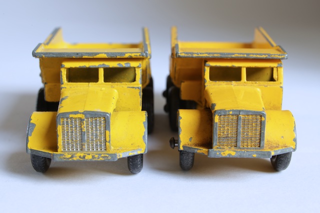

yellow and dark yellow, pretty much the same colours as the 6b. Code 14 yellow, code 19 dark yellow.
- yellow and dark yellow

Re: 6c Euclid Dump truck

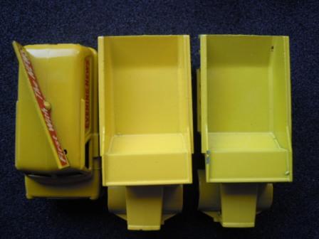

Hi Glenn, I can confirm your yellow and dark yellow variation. I am enclosing a photo from July 2012 with comparison of yellow shades. I will upgrade a list with new 6c variations. I think that there are 8 variations of the tipper (up till now 6 mentioned).DrJeep wrote:yellow and dark yellow, pretty much the same colours as the 6b. Code 14 yellow, code 19 dark yellow.
- DSCN2136.JPG (19.51 KiB) Viewed 9944 times

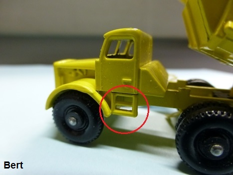

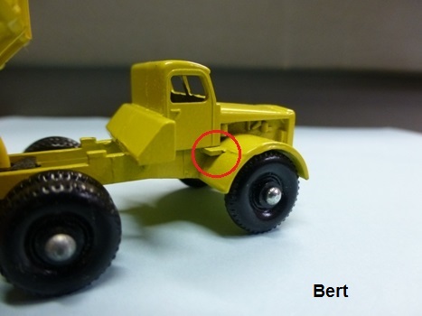

Hello Hugh, Antonin, Glenn and all,

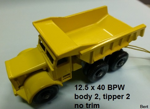

Santa started his deliveries in our part of the world early with a new variation for the 6c Euclid Tipper that has now joined our fleet.
The specs for this one are as follows:
A type tipper
Gap under A
E and part N missing along with thin crossmember
Thin step right side
No step left
All this equals
Body 2, tipper 2, no trim
12.5 x 40 BPW
Coded as 20a using the current table from Nick
The added bonus with this model is that it has light colour cab and dark colour tipper which are currently not differentiated within the codes.
Antonin, thanks for adding the colour comparison pic above, this was the one I was referring to in the other thread started by John.
Bert

- Light colour cab with dark tipper
- 1 bert 6c new variation.jpg (54 KiB) Viewed 9930 times
- No gap left side
- 2 bert 6c new variation no gap left side.JPG (49.7 KiB) Viewed 9930 times

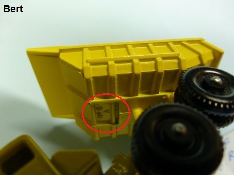

- Thin step right side
- 3 bert 6c new variation thin step rhs.JPG (45.97 KiB) Viewed 9930 times
- Thin cross-member and no E part N missing
- 4 bert 6c thin crossmember no E part N missing.JPG (58.11 KiB) Viewed 9930 times

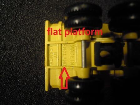

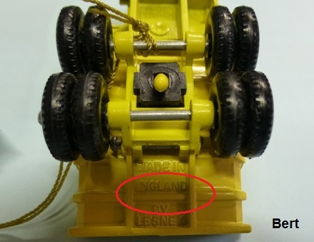

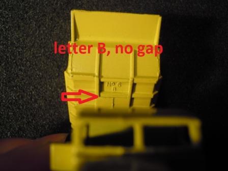

I am enclosing an unlisted variation of the tipper base. The last mentioned variation is with letter "B" with bar bellow and with "ENGLAND" on the raised platform.
I have the variation with letter "B" with bar bellow and with "ENGLAND" on the flat platform.
The next variation should be the same but without "E" in the word "ENGLAND", but I can not find it now. Sorry I have no photo, only a short notice. I do not remember if I have it or if I have seen it somewhere.
