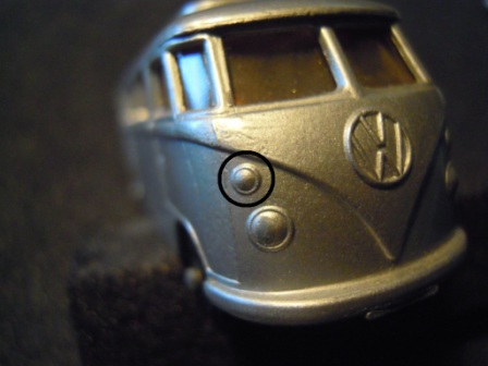

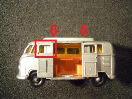

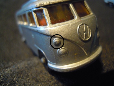

Just to remember, I have mentioned yet. There is one unlisted variation:
a) with small sidelights
b) with large sidelights
- DSCN4678.JPG (37.78 KiB) Viewed 3447 times
- DSCN4679.JPG (43.79 KiB) Viewed 3447 times
Re: 34c Volkswagen Camper
Is this just the difference between paired tooling, or is there a timeline associated with this variation?Diecast wrote:Just to remember, I have mentioned yet. There is one unlisted variation:

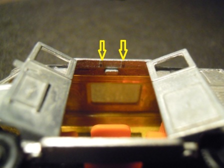

a) without door obstacle
b) with door obstacle
- DSCN5664.JPG (33.65 KiB) Viewed 3441 times
- DSCN5665.JPG (38.1 KiB) Viewed 3441 times
I think that it is the difference between paired tooling or a repaired die (because, in my opinion, the frequency of occurrence of the model is not 1:1).Idris wrote:Is this just the difference between paired tooling, or is there a timeline associated with this variation?Diecast wrote:Just to remember, I have mentioned yet. There is one unlisted variation:

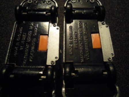

and one small variation on the base plate:
a) glossy
b) matt
a) glossy
b) matt
- DSCN5666.JPG (34.93 KiB) Viewed 3432 times

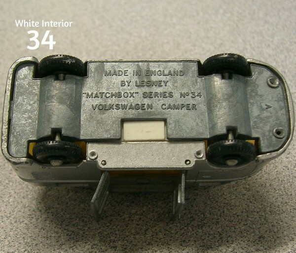

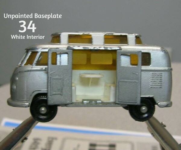

Any thoughts about this one posted on MCF Facebook page
- FB_IMG_1488904272057-600x500.jpg (56.87 KiB) Viewed 3174 times
- FB_IMG_1488904261751-600x513.jpg (95.12 KiB) Viewed 3174 times
- nearlymint
- Posts: 2330
- Contact:
Hi Reg,
First impressions would be a prepro, early casting with an unpainted base and white interior.

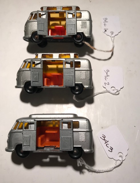

Variation 1 is listed with no ridge on the right door (the door with the wide ‘pocket’).
I have one with no ridge on the LEFT door (the one with the narrow ‘pocket’).
In the photo below, it has the 34c1a tag. Does anyone else have this version? Any ideas?
Thank you
Kurt
Thank you
Kurt
Happy hunting!
Kurt
Kurt

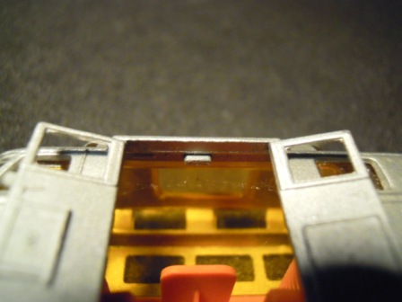

By the coincidence, Kurt recently showed us an interesting unlisted variation with no ridge on the left door (on the model with high roof). I have received the same model with no ridge on the left door but with LOW ROOF!!!.
- DSCN6189.JPG (30.52 KiB) Viewed 2841 times
