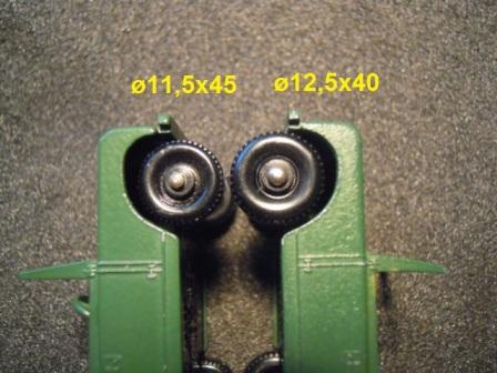

Idris wrote:Stannard has as variation 12B-5 a model with 12.5 x 45 BPW. Houghton lists what I suspect is the same model (as variation 12b-7), but this time with 12.5 x 48 BPW. In both cases, I believe the model concerned is Nick's variation code 7 (headlight and bumper trim, d/h, r/a, 1.5 mm with bulb, with tow hitch brace) which he lists with 11 x 48 BPW. Can any Member clarify the situation?
U.K. Matchbox did not examine the model.
You are right Hugh. The wheels ø11 x 48 do not exist. This is a mistake in counting. But there is a variation with BPW ø12,5x40. It could be a code 8.
