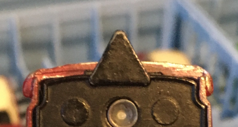

Recently noted that all my early models without the roof ejector ring have a narrow rear casting(bumper), when looking inside through the windscreen this is quite apparent.

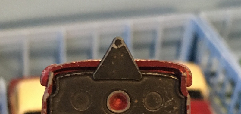

The later ones also seem to have a very small extension on the base but very hard to see, not sure where it is in the list yet as I will have to get my other ones together.
Early body
Early body
22a early casting.JPG (69.27 KiB) Viewed 5645 times
Later body
Later body
22a later casting.JPG (83.56 KiB) Viewed 5645 times

Hello Jason, my Red 22a with the ejector ring has the front axel brace and the narrow bumper.
My two Maroon models have no ejector rings both have the wide bumper but no front axel brace.
