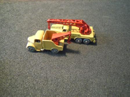

I think that the inspiration for the first colour variation was by 13a and 13b Bedford Wreck Truck

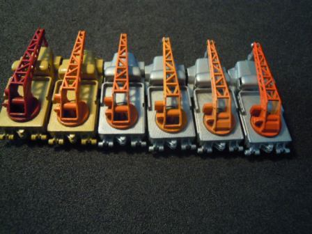

There are several colour or shade variations of the jib: red, pale orange, dull orange, bright orange, orange-red. Hard to describe all the colours exactly.

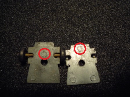

There are two unlisted variations, base plate with:
a) lower ejector ring
b) upper ejector ring

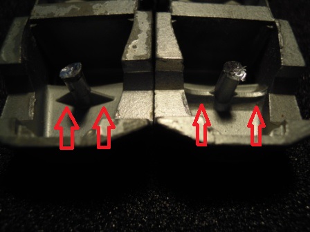

and another unlisted variation on the front boot rivet:
a) triangular brace
b) full width brace

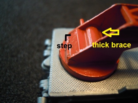

I am not sure if this variation was mentioned or exactly described. The jib has a step at the rear and thick brace on the round cross bar.
