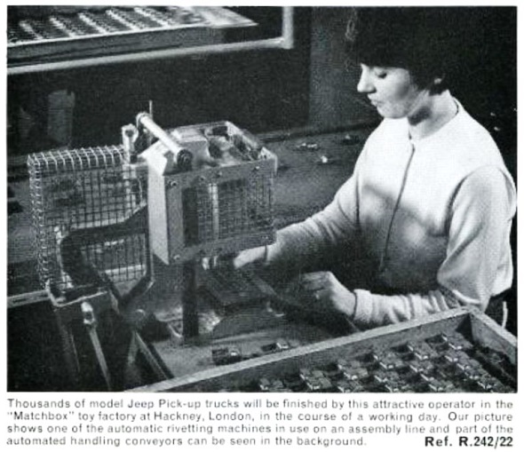

I have no pictures of axle production, but found this image from a Leney produced booklet showing a riveting machine. The description does not really make it clear what is being done, but a further few lines of text at the back of the booklet says glazing is riveted into the bodies and baseplates onto bodies are carried out by machines of this sort.
One riveting machine.JPG (114.61 KiB) Viewed 1390 times

The only heat generated during the deformation process is so low, that the lady could barely feel it when touching. Think about the fact that plastic wheels were processed and delicate woman hands had to take out the model back from the machine and place it in the tray.
In general a rivet head aquires, that the axle has to produte a minimum 1,15 times more material than its diameter. So if the axle is 1mm and the head should be 1 mm high, the end at the wheel had to be minimum of 1,15 mm long. The supernatant of 0.15 mm is the required material from which the rivet head is formed.
Infact this principle only works for the domehead on one end, which already was done in the preproduction before assembly. It is only feasible, if there is enough backpressure. The rivet head from the productionline is much smaller, because the needed backpressure would bent the axle. Viewed from the side the axle end is square shaped and only punched with a concave tool, which forms the produting square into a rounded shape.
