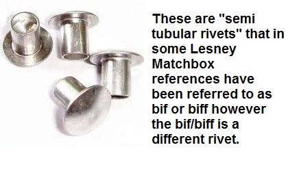

A Bif rivet is in sense a split rivet and used in leather work for belts, back packs, that is - to hold soft materials together etc. There are three or more methods used to secure a bif rivet, the best way is with a special tool( bif rivet setter).
The correct name for the rivets (referred to as bif or biff by some) used on Lesney models is a semi tubular rivet.

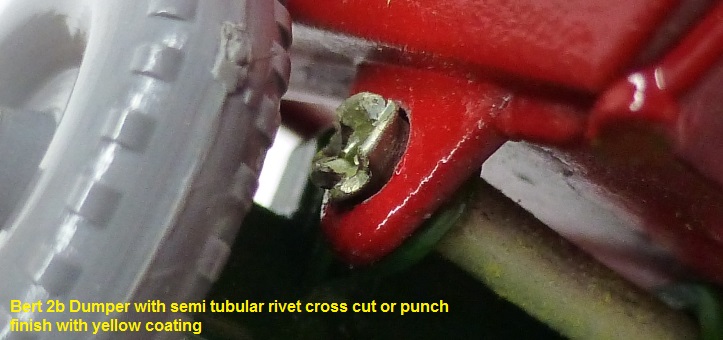

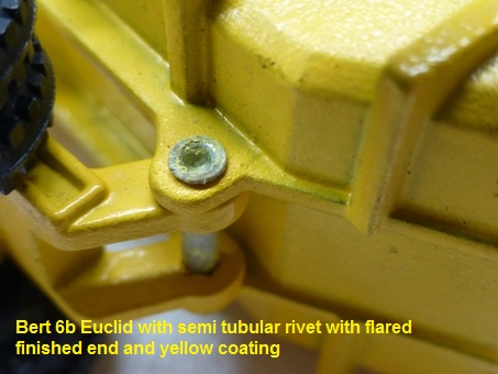

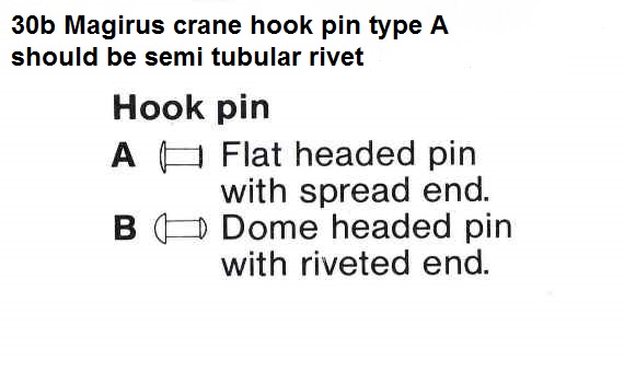

The rivets are used on the 2b Dumper, the front wheel on some 4c Triumph, 6b Euclid tipper and 30b Magirus crane hook, 64a Scammell hook along with some Major packs like M8 guy Car trailer pivot or M4a Ruston Bucyrus Power Shovel Taylor Woodrow boom pin as well as others.
The shank is solid but the end is hollow and it is the end which is flared, cut punched or flattened over after assembly to secure the fitting.
Attached are some images and drawings of the true bif as in split pin followed by the semi hollow rivet or semi tubular rivet as used on Lesney diecast with models mentioned above.

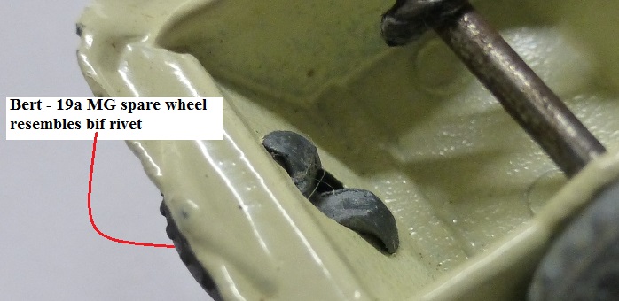

The 1-75 example that resembles a Bif (split) rivet in a diecast application is on the spare wheel on the 19a MG but that is part of spare wheel casting. Another place a true Bif rivet has been used within Lesney Matchbox is in the fastening of some carry cases on the corners made in the UK.

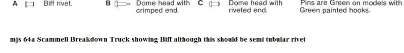

Whilst the pin used on the 2b,4c, 6b, 30b, 64a, M4b, M8b etc are all semi tubular rivet M J Stannard only uses the term Bif on the 2b , 6b, 64a whereas on the 30b uses flat headed pin with spread end description. He does not show any reference to a rivet like the semi tubular rivet on the 4c. This was catalogued post 1985, see reference tinman, schenk and zBret in Nick's variation pages.

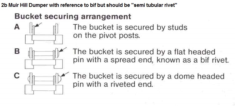

2b Dumper bucket pivot pin Nicks codes 5, 6 and 7

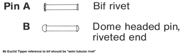

6b Euclid tipper pin Nicks codes 1 thru 6 ( Antonin code 1 thru 9 )
30b Magirus Deutz crane hook pin Nicks codes 1 thru 7

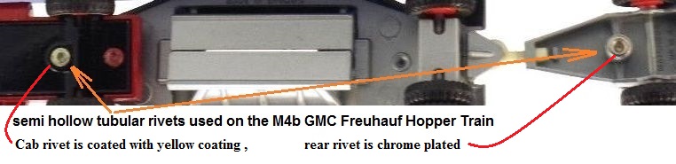

M4a Ruston Bucyrus model 22 – RB Excavator Power Shovel Taylor Woodrow boom pin

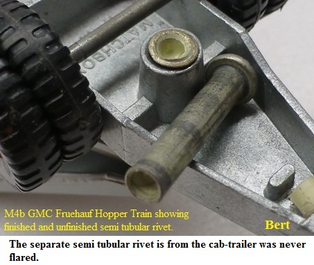

M4b GMC Fruehauf Hopper Train trailer pivot point (NAMC description - cab attached to hopper by single rivet) and again this is a semi hollow tubular rivet. One of my M4b has the cab-hopper rivet that was never flared. Please see image showing both rivets in one photo.

It should be noted that the head of a semi tubular rivet can come in various forms, round head, oval head, flat head, dome head, Pan head, mushroom head, Snap head, Button head, truss head along with other trade names depending on which manufacturer you reference.
9 mjs 2b reference to bif rivet.JPG (60.25 KiB) Viewed 1360 times
11 mjs 6b euclid reference to bif.JPG (33.81 KiB) Viewed 1360 times
12 mjs 30b hook pin reference.JPG (44.48 KiB) Viewed 1360 times
14 m4 Fruehauf Hopper Train showing semi tubular rivets.jpg (47.54 KiB) Viewed 1360 times
15 m4 hopper train showing two semi tubular rivets.JPG (81.09 KiB) Viewed 1360 times
