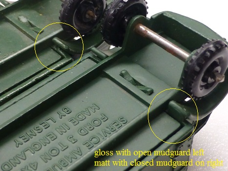

The open and closed left hand mudguard exist on models with and without the base plate hole.

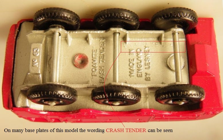

On the 63b additional text can often be found
63a gloss and matt open and closed mudguard.JPG (76.81 KiB) Viewed 3019 times
63b additional cast text.jpg (101.63 KiB) Viewed 3019 times
Re: Casting #63
I like the baseplate with ghosted wording, it also occurs on the Austin Radio Truck.

johnboy wrote:I like the baseplate with ghosted wording, it also occurs on the Austin Radio Truck.
..and don't forget that (as someone else pointed out on Befora) the 36a Austin A50 baseplate stated off reading Austin A70!
