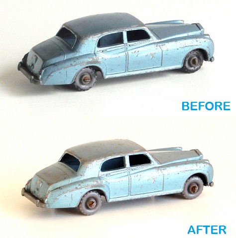

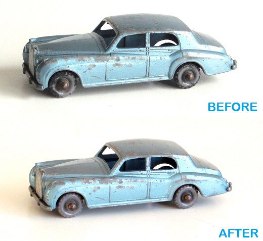

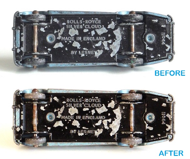

I had a go at cleaning the wheels on my recent Matchbox #44A with some nail varnish remover and the results can be seen below.

So thank's Guys for the valuable advice.
Re: Removing paint
Its been a few Days now since I cleaned the GPW wheels on the above model. On checking the model again there is no evidence of any degradation or solvent damage through the use of nail varnish remover, the wheels still have the natural sheen and no areas of colour discolouration and they are still solid to touch, suggesting they have kept their integrity. I am happy that I have not inflicted any damage to the wheels and will be using this method in future.
