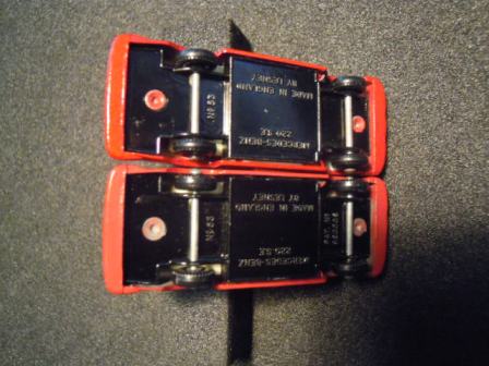

- DSCN5422.JPG (32.12 KiB) Viewed 879 times
Re: 53b Mercedes Benz 200 SE
Hi, I too can confirm nicks code 7 but with no Silver trim to the rear of the model.

Even though this had been discussed and even pictured by George or possibly Antonin during the LeFora days, the last two dark red Mercedes with fine treads and both base types were also delivered to our stores with a bright red body, totally different than the standard dark red color. You will find that in your second printing of Bob's Guide, (Whoopee) he notes this second 'shade' with only the patent number base as his variation 'H'.
I can add that the earlier base also came in that bright red color, we have had them both since new, and it is NOT just a shade difference. The 2 U.S. store bought models I have are BRIGHT RED, of a much lighter color than the 'stock' dark red commonly found on these. My guess is that these may also be the variations both George and Antonin have without silver rear bumper trim if they compare the colors to the common 'stock dark red models' in their collections.

Regarding the final issue, you are correct. Bob reported variation 53-2H as being "red, red rear bumper, patent no., BPW (2 shades)". By the sounds of it, there are actually two distinct reds rather than merely two shades and this variation code should therefore have been split.
