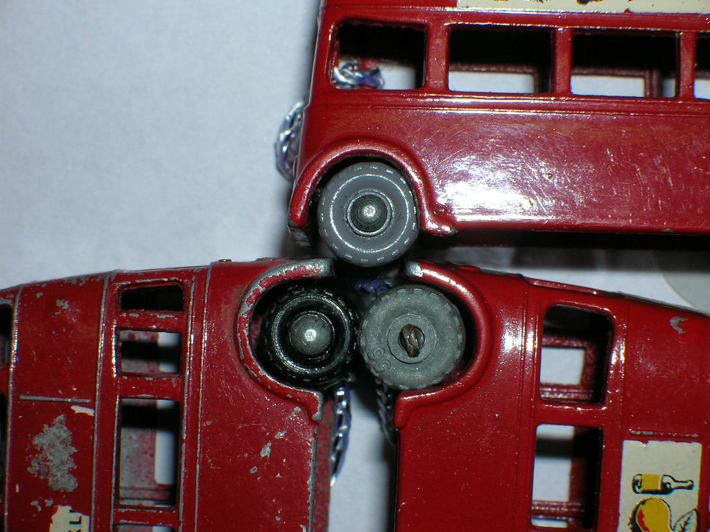

Hello Antonin.
A very interesting contribution.
I checked my models 56 models
I found this difference: the black wheels are smaller
as the gray and metal wheels.
I hope it's not an optical illusion.
But I heard already of trolley bus with smaller black wheels.
Greetings Mike
Greetings Mike
- eind.JPG (182.23 KiB) Viewed 437 times

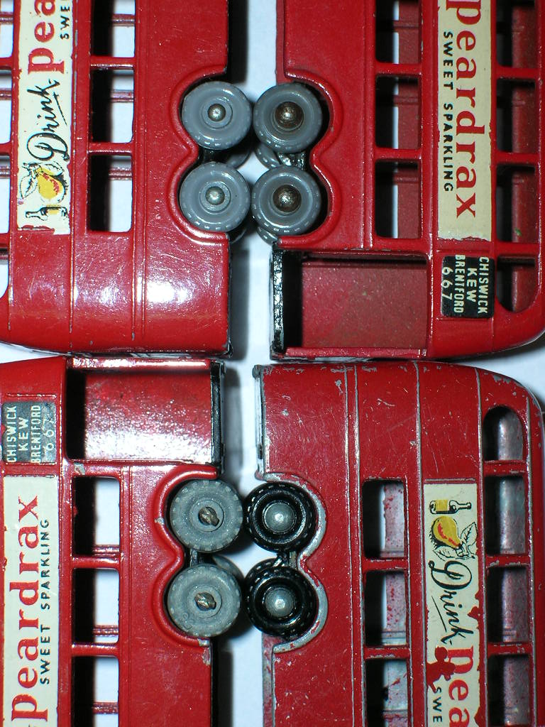

....... Interesting also the color difference in the
gray plastic wheels.
- jetzt.JPG (197.4 KiB) Viewed 433 times

Hi Mike
by your nice photos the wheels look like that they have a different diameter, it is partly due to an optical illusion and partly due to the metal and plastic wheels wheels have indeed slightly different diameters. Typically the metal wheels have approx. ø7,6mm and the plastic wheels approx. ø7,3-ø7,4mm. Interesting would be to find 56a Trolleybus with BPW ø8x18 (as Nick has predicted it by 35a and then it was confirmed).
