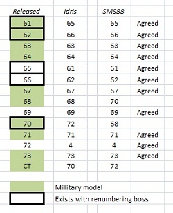

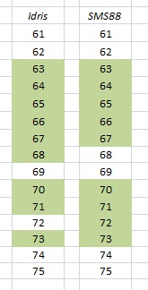

In order to save members brains, I have put the two proposals into a visual format. The first figure shows how the actual and suggested numbering relate to one another, whilst the second shows the original distribution of the military models:
- Renumbering 1.jpg (32.46 KiB) Viewed 1089 times
- Renumbering 2.jpg (18.07 KiB) Viewed 1089 times

Neat tables idris !
One point that occurred to me when thinking in terms of the bi-monthly or quarterly authorise new model meetings is that the 65a-66a-69a-70a were more likely than not authorised in the same meeting which would imply that these 4 models would have been the 1st planned #61-64 prior to the decision being taken to break up the number block of 10 consecutive planned new military models. There is no reason not to suppose that provisional numbers could change more than once
Perhaps we should have an opinion poll here to see how many members think the Centurion was intended to be #70 or 72 and how many think the Ford Thames has #68 or #72 under that #70?
