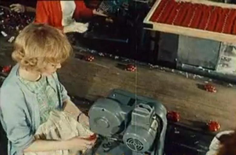

These two clips are the only ones I can find now Tractorboy. The areas you point out are the ones that we may need to see in better detail to show 'spinning', but they are what they are. These clips seem to indicate the machines in use are all pre-set with the operator simply inserting the model into a holder. Production is so fast and photography is so bad that we cannot make out what is happening here on these newer videos. The arbor press used to insert the rear spare tires on the Y Series Mercedes can be seen as much simpler than the motorized machine at 1:47 that she regrettably is not shown using. The 13Cs are so blurry in this video they cannot be distinguished, so I wonder whether more details were available in the same video that was downloaded years ago that I viewed earlier this week? kwakers

tractorboy wrote:the woman appears to be taking models off the line and uses a press but hard to see
numi wrote: please post those pics so that we can all view and make assessments to ascertain/determine whether some/most/all rounded axle-ends were actually electrically spun(via a spinning motor/spindle) or whether manually or pneumatically peened.Pics or vids of the actual peening/rivetting procedures are also welcome.
Thanks in advance.
Hello kwakers,Nick, idris, numi, Rodger and all,kwakers wrote: These clips seem to indicate the machines in use are all pre-set with the operator simply inserting the model into a holder. Production is so fast and photography is so bad that we cannot make out what is happening here on these newer videos kwakers
I believe this worker may actually be riveting the axle holding the hook on the 13c Thames Wreck Truck.
The models looks to be almost complete and making their way to the station ready to be trim detailed before being put into a tray prior to being boxed. I would think the hook assembly would have been the last assembly type task prior to boxing.
I would think this machine has a pre-set travel or stroke subject to the length of the axle, so one hand with the fingers are holding the hook to apply pressure to stop axle falling out and the other hand holding the model.
This type of machine can then be operated with a foot operated switch to activate tool. If you look closely at the video you can see her leg move at the same time the lower part rises. The jig in this case would be designed to suit the correct seating of the crane jib.
The amount of travel could also be determined by a bed or jig holding a component and varied accordingly for other tasks.
She does it quickly, but by the look on her face has been told she must work faster.
Footnote
Usually machines like this are guarded to prevent fingers, hand or clothing getting caught as can be seen in another clip where a spare tyre is being riveted in place. In this case the actual tool may be guarded but not visible to my eyes.
- 13c assembly line.jpg (45.79 KiB) Viewed 2776 times

I would have thought axles were spun and hammered at the same time to produce a dome effect. As stated a longer period would give a full dome whilst a shorter one, a flat spot on top. Over the years I have seen many different ends on axle ends from pure common models to rare and can definitely say they are all covered by Rogers photos.
